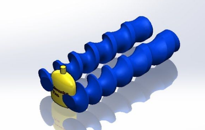

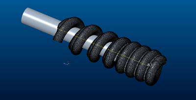

i would know if could be possible to repeat a part along a sweep feature keeping a specific orientation compared to the assembly, for example i would:
-repeat the grey part along the sweep cut keeping the same reciprocal alignment
-merge all the bodies obtained in a single one
-subtract the body obtained from the white one
the result should be similar to this one
but the way that i obtained it, is not easy to use and to manipulate and the subtract command always fail.
Maybe there is another way that i haven't considered how to do this.
Thanks  previously for the help

It is not clear to me exactly what you are asking. Look at this function as it may provide the resultant geometry you are seeking.

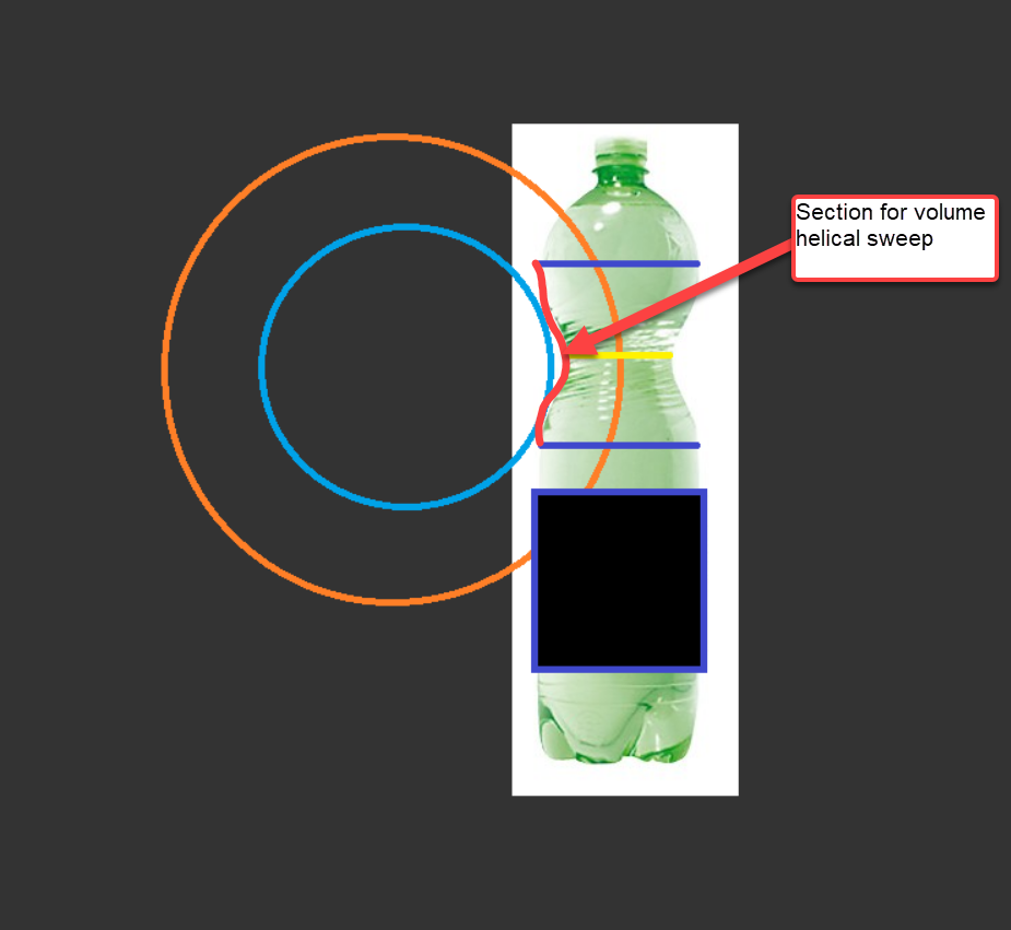

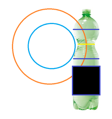

imagine a situatuon like this one .
Feedscrew with orange ext diameter and light blue inner diameter.
If i'll consider as diameter of the "housing" the yellow one the housing will be too small, if i'll consider the violet one'll be too large.
So i can't consider a section only and i'ts not a revolution.
Consider also that this ll change also according to the pitch along the feedscrew.
Another case is when u have shaped bottles so i can't consider it as a revoluted object, hope i was clear enought.

If the position of the bottle is constant relative to the feed screw cylinder, then a volume helical sweep will generate the volume needed to cut the screw. You would define the section in the volume helical sweep by using the bottle profile. Unless I am missing something it looks like this would work.
If one is to assume that the bottle position varies with respect to the axis of rotation of the feed screw, then it becomes more complicated.

Hi, you are perfectly right in this case but unfortuantely i have to work also with bottles like these that aren't obtained by a revolution of a section.
Image just for reference.
Just to recap, problems arrives once i have both conditions verified :
-feedscrew placed at an height different from the "bigger section" position
-bottle/section not obtained by revolution.
