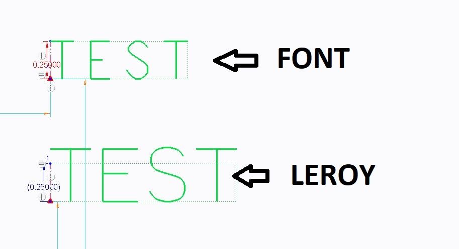

Please explain why Leroy characters are larger than you expect. I do not understand your problem.

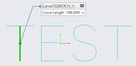

The scale with Leroy is larger than the specified size.  I'll show an example between "font" and "leroy":
Notice how "font" stays true to the text height.  Conversely "leroy" is larger scaled.  What I'd like to find out is whether it is possible to alter a setting to proportionally bring the text to the correct height.  I see that the height in the src header is 63 which is the max.  The width is specified at 36, but also there is an ICS of 1 and fixed width of 1 which likely means the individual widths take over.  Would it be possible to make a universal height change to all text characters?

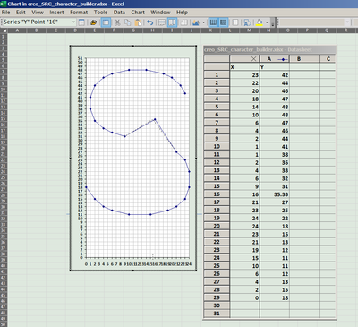

Another thing that I don't grasp.
The main problem when editing a src file is that PTC does not provide an application that would allow you to draw the shape of the character and then convert it to M and D commands. You have to print a raster on paper and draw the shape of the character in it.
Are you talking about printing off characters and reviewing against needed shapes or printing off a grid to help develop the M and D strokes?
Q: Are you talking about printing off characters and reviewing against needed shapes or printing off a grid to help develop the M and D strokes?
A: I mean printing off a grid to help develop the M and D strokes.

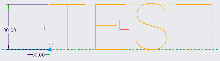

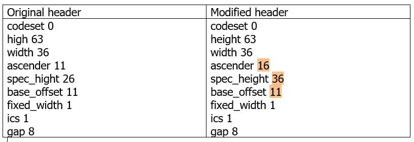

Problem: The scale with Leroy is larger than the specified size.
The result of the examination: It is caused by bug in leroy.src.
#73
"I"
width 16
m 8,47
d 8,11
Definition of the above character ends at 47.
base_offset + spec_height must be 47 ... therefore I set spec_height to 36
base_offset + spec_height + ascender must be 63 ... therefore I set ascender to 16
I compiled modified font and created new Sketch feature in new part and result is OK.]

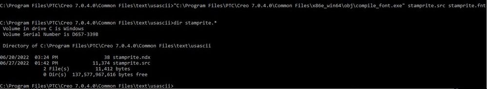

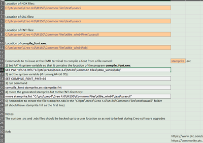

In my Google search I did find a thread related to Creo version 5.  In this thread there was I believe a compile terminal text.  In the example given it gave:
set COMPILE_FONT_PMT=36
compile_font.exe   isofont.src   isofont.fnt

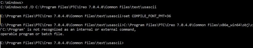

I tried this for my own generated text font name which I called "stamprite".  Before doing the script I copied the Leroy .fnt, .src and .ndx files and renamed them to stamprite.
I entered the "set COMPILE_FONT_PMT=36" line 1st and it entered without feedback.
Next I entered "compile_font.exe stamprite.src stamprite.fnt and got back the following message
I imagine this isn't good but don't know what it means in terms of communicating a change through.
I haven't really made any changes (as my intention will be) as of yet.
Creo did at least read in the stamprite font type.
I don't know how to make the intended changes to the src and have it carry through.

suppose that stamprite.src is located in C:\Users\Public\Documents directory.
You have to:
  • open Command prompt window and run following commands (modify last command according your Creo installation)
  • cd /D C:\Users\Public\Documents
  • set COMPILE_FONT_PMT=36
  • E:\PTC\Creo7_050\Creo 7.0.5.0\Common Files\x86e_win64\obj\compile_font.exe stamprite.src stamprite.fnt
Martin Hanák

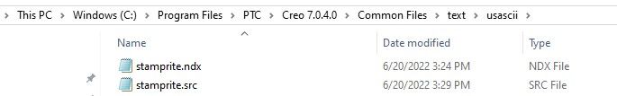

Martin, thank you for looking at my problem.
The location of both the src and the fnt is in the Creo installed directory.  If this is wrong let me know.
In my case the src file is:
Consequently I am assuming that I would enter cd /D C:\Program Files\PTC\Creo 7.0.4.0\Common Files\text\usascii
Once there I would enter the set COMPILE_FONT_PMT=36
I would then continue in the command prompt to my fnt file which would be C:\Program Files\PTC\Creo 7.0.4.0\Common Files\Text\usascii
And then would I enter the compile_font.exe stamprite.src stamprite.fnt or would this be one long line?
Could you verify the above, I'm not fluent in using Command Prompt.
Then anytime I needed to make changes I would follow the same script I am assuming.

OK, you can use two following commands
but third command must be
C:\Program Files\PTC\Creo 7.0.4.0\Common Files\x86e_win64\obj\compile_font.exe stamprite.src stamprite.fnt
 and finally you have to move stamprite.fnt from C:\Program Files\PTC\Creo 7.0.4.0\Common Files\text\usascii to C:\Program Files\PTC\Creo 7.0.4.0\Common Files\x86e_win64\text\usascii directory.
Martin Hanák

Q: When all of this is entered does this just save what was done in the src file into the fnt file?
A: Yes, compile_font.exe reads src file (text) and creates fnt file (binary).
src file format
see https://www.ptc.com/support/-/media/support/refdocs/Creo_Parametric/8,-d-,0/installguide80.pdf?sc_lang=en
start at page 104
height & width ... see page 109
definition raster ... see page 111
height & width values define size of the raster which is used to define character shapes.
The actual height of the character is defined only in the drawing.
#73
"I"
width 16
m 8,47
d 8,11

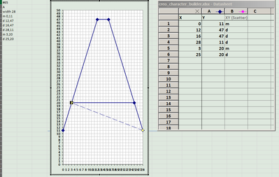

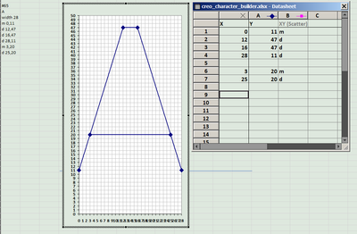

Martin:  It looks as if you have given me everything that I need to solve this issue.  That is awesome that you could uncover the errors in the src file!  I will run through the entirety of your solution and feedback if I get stuck.
A minor question before trying this out; would the grid size be the same as the character height 63 and the character width of 36?  In actuality the only potentially dangerous character would be the "1".  This would only require the top slant and lower horizontal line for the M and D moves.
MartinHanak
(To:pimm)
#49
"1"
width 4
m 2,48
d 2,11
Definition of digit one has width 4, therefore you cannot add another slant line easily.
Maybe you can use definition of digit four which has width 28
#52
"4"
width 28
m 23,11
d 23,47
d 20,47
d 0,27
d 0,24
d 28,24
and use it to create new definition of digit one
#49
"1"
width 28
m 23,11
d 23,47
d 0,27

Martin:  I finally had the chance to put this all together today.  Unfortunately something isn't working correctly on the compile.  I will attach the message that I am seeing in the Command Prompt.  The 1st command script worked.  The set script line didn't show any error but nothing changed to my eyes.  The third set of script it does not like.  I am getting a message that the word Program is not recognized.
Any idea where I am failing?
MartinHanak
(To:pimm)
path C:\Program Files\PTC\Creo 7.0.4.0\Common Files\x86e_win64\obj\compile_font.exe contains space characters. Because of this it must be enclosed in quotation marks as shown below
"C:\Program Files\PTC\Creo 7.0.4.0\Common Files\x86e_win64\obj\compile_font.exe"   leroy.src   leroy.fnt
Martin Hanák
pimm
(To:MartinHanak)
Martin:  I am sorry for all of the trouble but something didn't register correctly.  I will include all of the text that I entered in command prompt.
Open Command Prompt
Once there enter set COMPILE_FONT_PMT=36
Thirdly enter C:\Program Files\PTC\Creo 7.0.4.0\Common Files\x86e_win64\obj\compile_font.exe” stamprite.src stamprite.fnt
There is a chance that I didn't get one of the spacings correct.  It could be something completely different.
One point of curiosity is that the recommended script includes the obj folder even though none of the .src, .fnt or .ndex files reside there.  Could it be possible that I need to move something into the obj directory?
Another thing to note is that nothing seemed to happen when entering the set COMPILE_FONT_PMT=36 line, but there was no error.  When I entered
C:\Program Files\PTC\Creo 7.0.4.0\Common Files\x86e_win64\obj\compile_font.exe” stamprite.src stamprite.fnt there was a brief command prompt blink but nothing else appeared to happen.
Also to note, I changed the Leroy .src file with the recommended sizes and similar to when I entered for stamprite the entered text size did not scale properly.
MartinHanak
(To:pimm)
Open Command Prompt
step no.1
after finishing compile_font.exe” stamprite.src stamprite.fnt command you will find stamprite.fnt file in C:\Program Files\PTC\Creo 7.0.4.0\Common Files\text\usascii directory ... please verify it.
step no.2
You have to move stamprite.fnt file to C:\Program Files\PTC\Creo 7.0.4.0\Common Files\x86e_win64\text\usascii directory.
step no.3
You have to create stamprite.ndx file in C:\Program Files\PTC\Creo 7.0.4.0\Common Files\text\usascii directory.
Copy leroy.ndx to stamprite.ndx, open stamprite.ndx in Notepad and replace leroy.fnt with stamprite.fnt.
step no.4
Start Creo and create new Sketch feature containing text. You will be able to set stamprite font for it.
Martin Hanák
pimm
(To:MartinHanak)
Martin:  I reviewed the steps you suggested in your last post.
What I am seeing is that I fail on step 1.  I don't see the stamprite.fnt file being generated in the C:\Program Files\PTC\Creo 7.0.4.0\Common Files\text\usascii directory.
Other differences that I am noticing.  I previously copied and renamed a file that I built for the stamprite.fnt to match other files that already were in the x86e_win64\text\usascii directory.  (There already was a leroy.fnt file, I copied and renamed that).  Thinking that this might be the problem I renamed the stamprite.fnt file that I made and tried the Command Prompts again, but this didn't change anything.
Also; I previously copied and pasted the leroy.ndex file and made a stamprite.ndex file.  I also internally changed the text to follow stamprite.
Once again I am sorry that this hasn't worked the way it should.
MartinHanak
(To:pimm)
please replay uploaded stamprite.mp4 video. It shows how I created stamprite font from leroy font.
I also uploaded font files created on my PC in stamprite_font.zip file.
Martin Hanák
Thanks @MartinHanak for sharing this information.  I wanted to share an Excel workbook I've created to help me remember how to do this.  Sheet 1 acts as a "graph paper" and aids in visualizing the character being drafted in an .SRC file:
(the old Excel chart object lets you click on individual points and drag them for a more interactive experience)
Sheet 2 of this worksheet creates the commands that need to be typed in at the terminal in order to compile your .SRC files and transfer the .FNT file to the correct location
(as you can see, I populated the orange input fields with my Creo4 installation locations; you would have to adapt to your configuration)  Afterwards, you can just copy and paste the white cells into the terminal.
MartinHanak
(To:pausob)
thank you for uploading Excel file. I was able to open it and modify sample S character.
Note: Unfortunately I do not see the way how to use the tool for letters like A,B,E. (because their definition has several branches).
Martin Hanák
Well it's not meant to be a FontForge competitor 😄
But these SRC font files are relatively simple.
Just a string of points connected by lines drawn (d) or not drawn (i.e. m for move)
We don't want the "move" to be drawn, so have to put in an empty row above it:
Most of the connections are typically with d-lines, so it is also easy enough to manually format the few m-lines in the chart:
Anyway, I can see how making your fonts with graph paper is also kind of fun, and this is the easy part  - compiling and deploying them... that can be quite a nightmare
pimm
(To:MartinHanak)
So frustrating.
Martin your video was exceptionally helpful.  I followed this from beginning to end.  The only difference was that I had already generated a .ndx file.
When I showed contents of the directory this is what I show.
The only other difference that I could note is that you were able to copy, modify and save the stamprite.src file right in it's folder.  In my case I had to move the file in order to make this save, and then return it.
MartinHanak
(To:pimm)
@pimm wrote:
So frustrating.
I guess you do not have full access rights to Creo sub-directories. Therefore you have to copy stamprite.src for example to C:\Users\Public\Documents directory and compile it there.
Martin Hanák
pimm
(To:MartinHanak)
Yes! Finally.
Changing the directory to user document and following your video closely I was able to verify that the change indeed works.
Thank you for not giving up on this.
Hopefully in the future there will be others that can gain the appreciation of being able to modify the Creo Text Fonts.
The "1" is a little off (it did apply a line though) but I think that perhaps Pausob's follow up might shed some light.
Thanks again!
