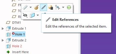

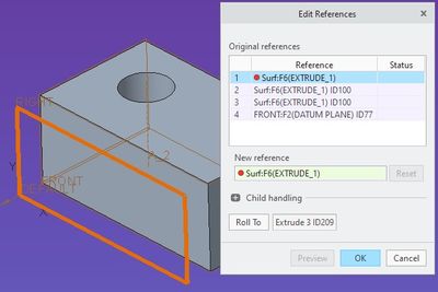

Changing the extrude depth from Blind to Up to Selected does seem to change the identity of the surface.  Possibly because Up to Selected does not create a "planer" surface.  Your example is a planer surface since it is up to a plane, however up to selected can also create a 3D surface.

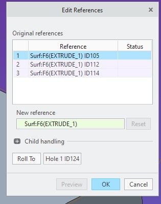

To fix, do not redefine the feature.  I suggest using Edit references.  In this case it is a bit tricky because Edit references does not show a missing reference.  However, it is known which reference changed.  The first reference is always the plane of the sketch or the hole start.  Select the "new" surface for the first reference and select OK.
I would also say this "glitch" may be worthy of a support case or Idea.  The hole function does not seem to be able to follow the change from a surface created by a blind extrude to a surface created by an up to plane extrude.  The extruded (sketched) hole, I created, followed the change, but exhibited the same irregular behavior in the refererences (Edit references does not show it missing, but also does not highlight the surface or show an outline of the original as it would normally for a missing reference)
