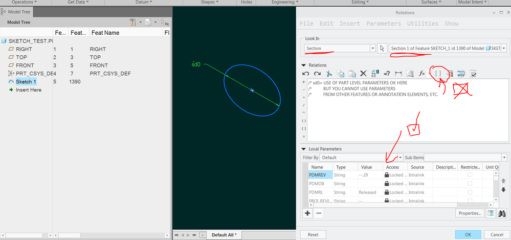

My goal is to reference a defined local "sketch feature" parameter from the "sketch section" associated with the same sketch feature.  Intent is to define a sketch dimension to the value of the parameter.
Creo help suggests that the way to do this is by qualifying the parameter name with the feature ID, such as:
    <param_name>:<feature_id> or :<feature_name>
or perhaps
    <param_name>:FID_<feature_Id> or :FID_<feature_name>
both forms have been tried.  These referencing syntax forms are not working.
Example:
  Sketch SK_123 exists with Feature Number 10 and Internal Feature ID 50 (obtained via Feature Information).
  Within "Feature SK_123 id 50" (given in the Relations dialog when "Look In" is "Feature") parameter ABC is defined.
  Within "Section 1 of Feature SK_123 id 50" (given in the Relations dialog with "Look In" is "Section") is relation sd0 = ABC:50 (or ABC:10 or ABC:FID_50 or ABC:FID_10 or ABC or any of the other variants noted above), where sd0 is a dimension.
Result is:  "Relations have errors"
If I do not qualify the parameter name, then a Part level (top level) parameter is created which is what I do not want.
Any ideas how to make this referencing work?  Thank you.

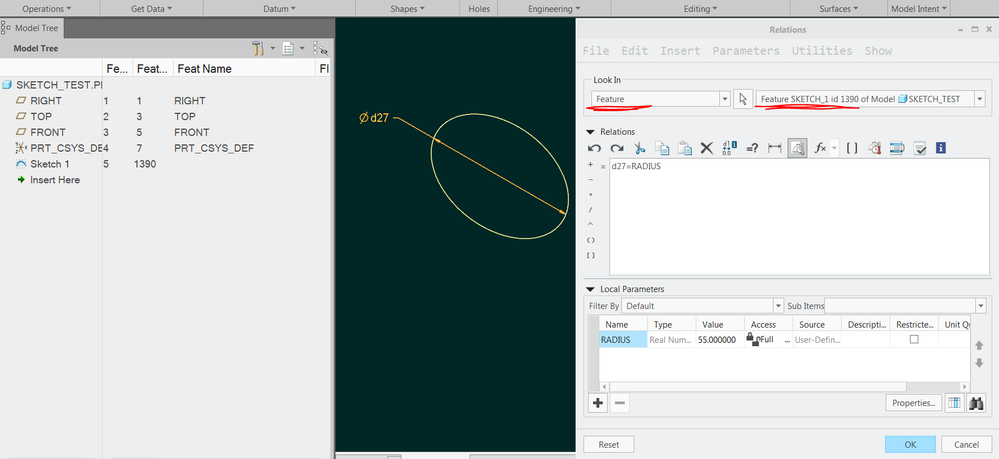

I think the problem is that section relations (that is, the ones that have the sd0 "sketch dimensions") can only reference part parameters:
However, you can make a sketch FEATURE relation that can drive the generated "feature dimension" to be equal to the value of other parameters in the model, including its own sketch FEATURE parameters (in which case, the :FID_xxxxx syntax is unnecessary):
note how there is that bit of that magic that happens as sd0 becomes d27...  I never really understood why Creo works this way, but...

Yes that worked!  Relations within the section are locally solve, but with this approach it appears the relation results are subsequently "pushed" into the section.
After I made the change, two re-generations were required to get all geometry to update so seemingly the 1st pass re-calculation resolves the value within the sketch feature, then the 2nd pass re-calculation provides that value to the section (and other things are dependent upon that section so they did not update initially).  Depending on how many times calculated values pass from sketch feature to section, it might imply the number of necessary re-calculations could grow to well more than two.  Likely to potentially confusing to subsequent users of the model.
Seems Creo could benefit from a solver that re-calculates as necessary until values resolve which is exactly what something like Excel does, calculates cell dependencies until exhausted.  I may need to plow through the config options, maybe it is buried in there.
Thank you for the insight!
