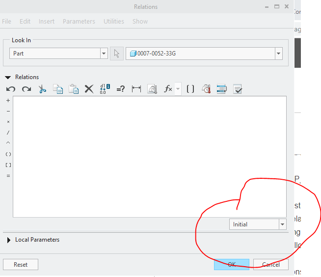

Open the relation editor, in the lower right corner is a drop-down that says Initial. Click the arrow and you have the option for Post Regeneration relations. In family table parts the weight will not update unless it is done as a Post regeneration relation. I use this for all of our hardware items so we can get the weight into the assemblies.

In the particular part I am looking at now, I do not have any Post Regeneration relations.
