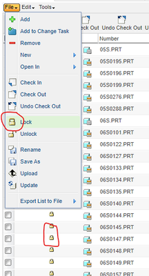

I have them all as locked in the top assembly- is that what you mean?

Locking files in workspace looks like this:
