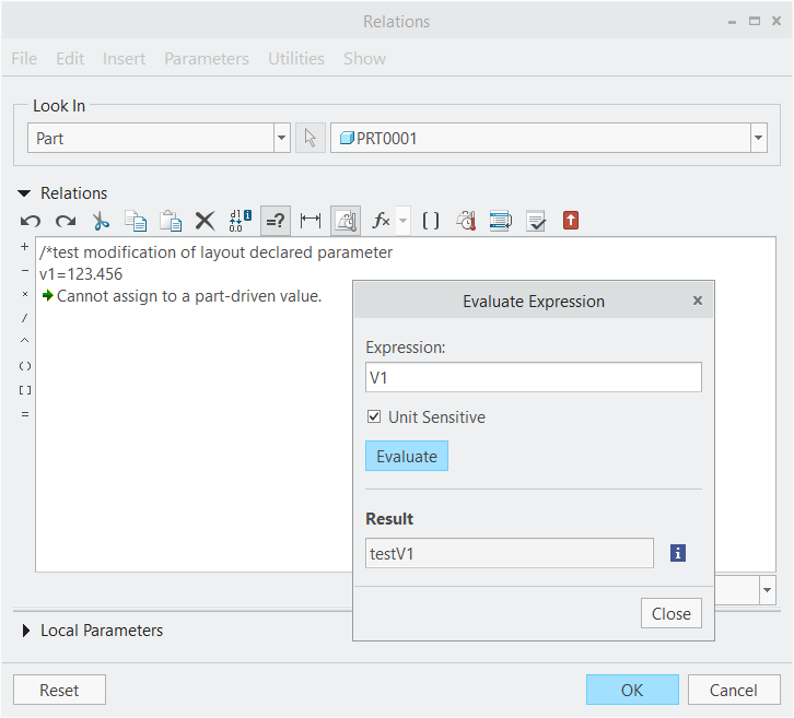

tbraxton
(To:KenFarley)
I just quickly tested out the concept of using a layout to "lock" the parameter in the context of part mode relations. It does appear that a variable defined in a layout  is "protected" in part mode while the layout is declared. If the layout is undeclared the parameter type remains protected.
In a layout I defined a parameter of type string v1=testv1. I declared this layout to a part and then attempted to redefine the variable using a relation. This is the result; Cannot assign to a part-driven value.

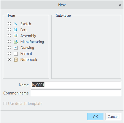

tbraxton
(To:KenFarley)
You do not need Creo Layout product/module for this. Layouts (.lay) are part of core Creo parametric functionality. PTC naming of products causes so much confusion.
Try this in Creo; CTRL+N and look for Notebook file type. If you see Notebook in this window then you can create and use a layout.

KenFarley
(To:tbraxton)
When I attempt to create a Notebook get the following:
This functionality requires one of: NOTEBOOK
So we evidently don't have whatever module includes this.

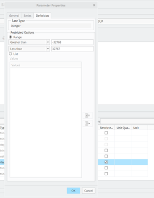

I always thought that INTEGER type of parameters were kind of odd - for example, it's not supported in Pro/PROGRAM...  And you can't do the "force" a parameter to become an INTEGER type though this relations tomfoolery.
I'd avoid using them altogether.  What's the point?  It's not like you need to have integers for that infamous itos() function to work 🙂

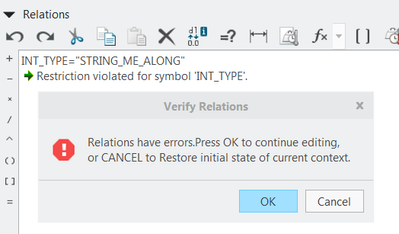

Anyway, I found a Pro/Work-Around if you want the error thrown if a "real" or "string" value is being assigned to your integer valued parameter: Make it a restricted integer type - let's say less than 32767 and more than -32768:
If this kind of parameter is then assigned an incompatible value:

Ok, forget about my comment about integers; no doubt that they have advantages.  I submit that you were are operating under a (false) assumption that Creo relations form some kind of a "strongly typed" computer programming language.  To me, it's no surprise that the system works in a wonky ways.
does the provided workaround address your type-concerns?

pausob
(To:KenFarley)
I'm curious as to why the demonstrated "restricting-the-parameter" trick would not qualify as a work-around that addresses your concerns about the data type of the variable changing on you.
