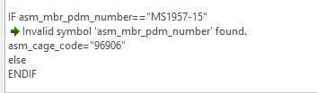

I have a parameter called cage_code. I want the blank cage code in the bom column to read 96906.
I have another parameter called part_number. I want part_number MS51959-15's cage code to read 96906, which is currently blank.
I saw a tutorial on Youtube that showed the following relation that worked:
IF asm_mbr_part_number=="MS51957-15"
asm_cage_code="96906"
ELSE
ENDIF
This looks pretty straight forward and looks like it will work. Why does it not?
Do I need to do something to the cage code in the bom that reads &asm.mbr.cage_code? I tried something like &rel.asm.mbr.cage_code. That does not work.
Please help.

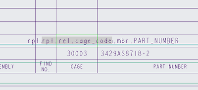

The way I have handled this in the past is add a new repeat region relation parameter for the cage code, in my example, I use "new_cage_code".
I change the column in the table from asm.mbr.cage_code to rpt.rel.new_cage_code
new_cage_code=asm_mbr_cage_code

What am I doing wrong?
StephenW
(To:wfalco)
There is always something that snags these up!
Does that part file actually have a cage_code parameter, sometimes thats the snag, and I sure don't remember how to fix that...
Unrelated:
Also, I noticed,  I used asm_mbr_name=="MS51957-15"  but when I looked at your setup again, you used asm_mbr_part_number=="MS51957-15"
So try changing to your relation to IF asm_mbr_part_number=="MS51957-15"
You are right. I needed to change name to part_number.
However - It is still not working.
The part does have a cage_code. But it is blank. I'm not sure if that has something to do with it.

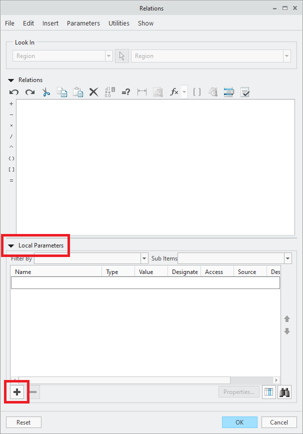

MartinHanak
(To:wfalco)
please read following information carefully.
1.]
I assume the parameter cage_code exists in all models
2.]
I assume no repeat region table cell contains &asm.mbr.cage_code
3.]
If the conditions from points 1 and 2 apply, then you need to add the parameter asm_mbr_cage_code manually in repeat region Relations dialog box. Parameter type selected is not important - Creo will change it to Unknown.
4.]
Put &rpt.rel.new_cage_code into repeat region table cell
Martin Hanák

kdirth
(To:wfalco)
Try this:
Edit repeat region cell for CAGE to rpt.rel.new_cage_code.
Relation:
if asm_mbr_name==”MS51957-15”
new_cage_code=”96906”
else
new_cage_code=cage_code
endif
