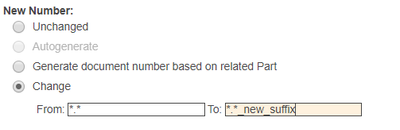

I was able to add suffix to all parts using "set new name" in windchill. I've attached screenshots below.
My question is how would I go about if i had to remove the new suffix from the name and go back to only the base number?

Have you tried the "reverse" of your original change pattern? Like this:
*_suff.*   -->   *.*
*_suff.*   -->   *.*

Sweet!! Thanks it worked!
