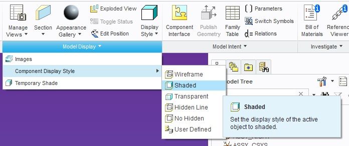

kdirth
(To:dbolden)
Try this setting.  Sellect the transparent part then select shaded from the menu shown below.
