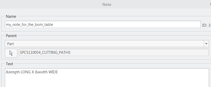

pausob
(To:lockarde)
I am late to this discussion and it seems like you have a solution that will work for you.
Still, I would like to offer an alternative to this "description string building" relations logic.
The method is based on using note type parameters.
In my opinion, most of the time it is easier to build such descriptive strings using part notes, because dimensions and parameters can be "recalled" in them using the syntax &dimension_id or &param_name[.X]
Also, you can have your dimensions (lets say you called them length and width) defined to be "fractional" in nature.
So you build a part note which says something like this:
You can then define a part parameter of type "Note", which value will be the above note's id # (3 in this example)
Lets say this note parameter was called "DESC_NOTE"
Then you simply call out this note-parameter in the repeat region
(&asm.mbr.desc_note ...) and it will show the note - in its original formatting - in your drawing's table.
