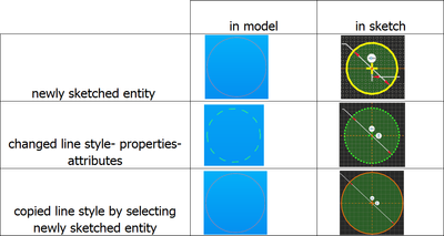

I got a bunch of quite complex sketches, that serve as gasket centerline in the part.
to better see them in the skeleton model assembly, I changed properties of those sketches to a random, different than default appearance.
then, as I wanted to go back to their previous style , I've drawn a new sketch and in properties of the sketch copied the style from existing and selected that new entity.
result is far from expected, as now I have a line, that is visible the same in 3d, but in different color inside the sketcher compared to fresh sketch.
Any tips in resetting the line style of entities that were changed to default style without the need to re-draw all of them again  ?

I'm not sure.  On my system (creo 10) - the custom properties revert if I set them to those of a newly drawn line in the sketch.
- or explicitly assigning them the color "Sketch" and linestyle SOLIDFONT...
