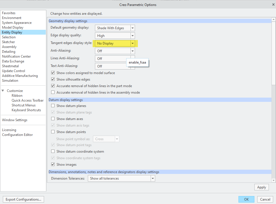

Resume the problematic features with the rounds. Then change the display of the tangent edges to not displayed. Do you need tangent edges shown in any drawing view?
If the unwanted lines are the tangent edges of a round, then they will not be visible after making this change to the display status.

Tangent edges are already set to "No Display".  There are individual views within this drawing that require tangent edges to be displayed but this is not one of them.  View properties, of the silkscreen view, also has tangent edges to set to "None", same behavior if set to "Default".
