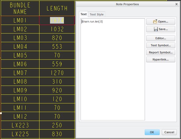

Is there any option to round of the bundle length values to nearest 10's. i.e 1674 to be 1670.
Able to control only decimal places in repeat region.
Please advise if anyone know the option.

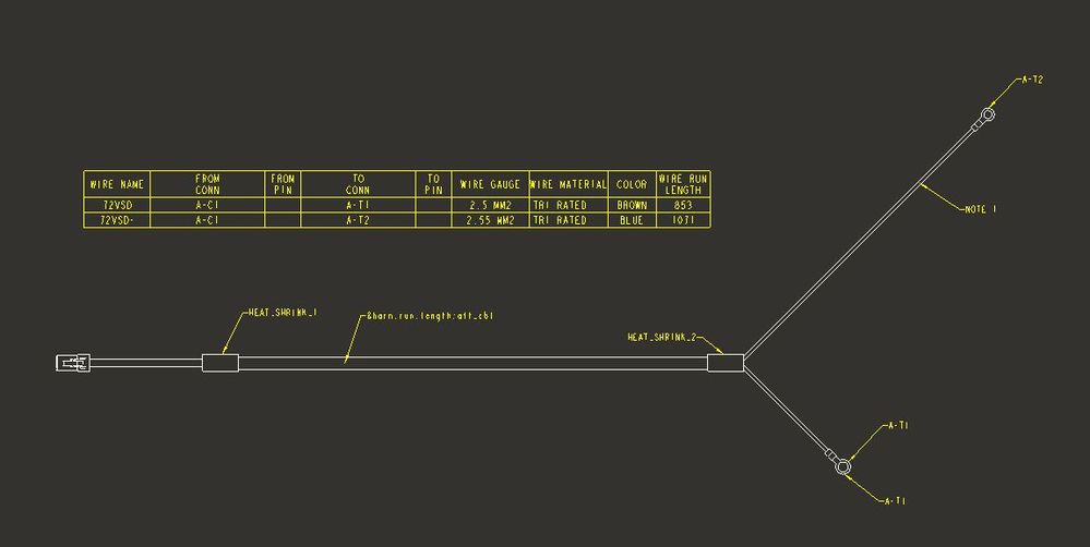

Request you to create relation for this subject. Attaching herewith sample harness drawing with spool table.
Below is the default values which getting from the harness file.
I would like to have length values in 10's as follows,
146 -> 150
134 -> 130
147 -> 150
Vijay K G
First, I would not recommend to ROUND DOWN on any cable length...you will be hitting your head against a wall if your cable is too short.
The calculation (ROUNDING UP) is simple:
CABLE_LENGTH = 144
ROUNDOFF = 10
CABLE_LENGTH_COR = CEIL(CABLE_LENGTH/ROUNDOFF)*ROUNDOFF
Or if you realy want to use a ROUND function:
CABLE_LENGTH = 145.556371
ROUNDOFF = 10
CABLE_LENGTH_COR = FLOOR((CABLE_LENGTH+ROUNDOFF/2)/ROUNDOFF)*ROUNDOFF
This also works if you want to round to a decimal value, just change the "10" to "0.1" for example.

I tried the relation which you advised here. I can't able to achieve the results.
If you could help me, please check with my sample file (Creo 3.0 M090) and show me the relations or updates table file.
Vijay K G
Mr, Martin Hanak helped me by sending the updated files with the same option you mentioned here.
I missed to call the relation parameter. Now I got it...
Thank you very much for your timely support.
Vijay K G
