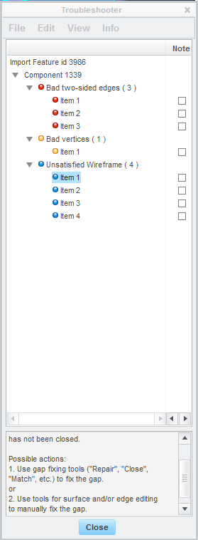

I have file from client that creo imports as surface. With IDD I found out there are a few edges that gives "Bad two-sided edge" it also gives a solution, that says use the"Merge Crv/Wfm". Where could I find this tool?

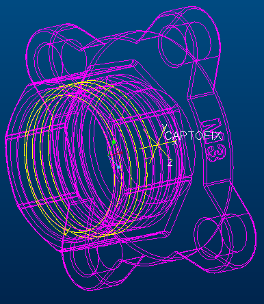

Thanks for informative reply, however, that was first thing that I did and most of the time it worked for me as well. However for this model it doesn't. When I go into geometry check it shows for me a few problems that repair doesn't fix. I usualy ignore Bad vertices, it seems creo handles them well. However other two types of problems I don't know how to resolve.
unfortunatelly I do not know how to deal with IDD geomchecks.

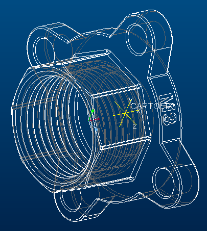

I installed CR2 M230 and followed procedure published on 2017-09-08 01:58 PM. Resulting model is attached.
Note: I hope you know that every imported model needs special healing procedure.
