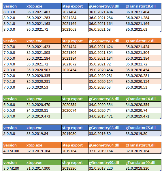

Can I tell from the STEP header what version they use? There's the string " 'CREO PARAMETRIC BY PTC INC, 2020053' "
G**gle couldn't match that 2020053  (build number?) to any version list.
Lars

Build Code 2020053 is the build code for Creo Parametric 7.0.0.0
TomU
(To:RandyJones)
The Creo build code, which usually matches the xtop.exe file version, does not necessarily correlate with the STEP header.  The header seems to track with the 'gGeometryXX.dll' and 'gTranslatorXX.dll' files instead.

Thanks to have pointed that out! I nevertheless confirm in this specific situation that internal datecode 2020053 is the common build code for both xtop.exe and step file generated from Creo Parametric 7.0.0.0.

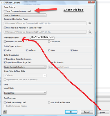

Now that I have a better understanding of what you mean when "STEP import attempt fails in INVENTOR" (hang/freeze of Inventor if Step file is large in the scope of a vritualized environment), I have no knowledge in Inventor, but based on what I can find in this area in their Knowledge Base, you may want to try again after having:
Something to try: In the options dialog, check the "Save Parts During Load" button. As Inventor processes the assembly file it will create part files out of the individual entities in the step file. With this option checked it commits them to disk as it goes instead of trying to keep everything in memory. This has made the difference for me in being able to import large step and iges files. I was able to import a 285 MB iges file this way a few weeks ago.
If none of above approaches help, I'm afraid you'll need to wait for a further guidance from Inventor >Technical Support via the ticket you raised with them.
Serge

thanks for digging that out of the Autodesk forums. Been there, seen that... and here comes the "regression": Recent versions of Inventor (and other of their products, iirc anything >2017) do NOT HAVE that option to Save Parts / Components during load. Gone. Abandoned. Removed. They nowadays (where everyone has trillions of Gigs of RAM) eat ALL into Memory and want to write out ALL once they are finished digesting. Brought that to their attention... so far no sign of them bringing that feature back. What shall I say ...
For the report thing: That's not an option when one uses the GUI import in IV directly; something like that is there if one uses their "task scheduler". No matter whether on or off. If On, it creates a report that says something like: "Eaten up all memory, tasted fine, thanks. Bye bye."
Nope, have to get them those files so they can see where it gets stuck... will be back to report.
