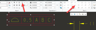

I wish to save this note as a symbol, but cannot get the feature control frame to come through. How can I save this other than an image?
StephenW
(To:ScottJohnson)
Instead of making the FCF as actual GD&T feature, make it as a note utilizing the box function and symbol pallette within the note creation ribbon.
3 REPLIES 3
StephenW
(To:ScottJohnson)
ScottJohnson
(To:StephenW)

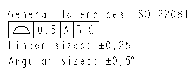

I can do that, but the boxes will not be there when I place it in another drawing.
They should copy just fine.  The box button is just inserting the box defining text into your note ( @[***@] )
If you look at the properties of the text, in the text tab you will see:  @[⌓@]@[0.5@]@[A@]@[B@]@[C@]
