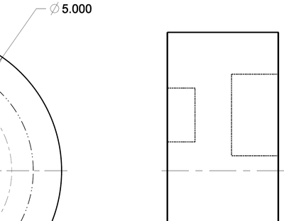

I'm in Creo 7 & Adobe Acrobat X.  I do a Save As/Save a Copy/PDF and the PDF I get has really short dashed lines that are supposed to represent hidden lines, there not scaled to the size of the part.  This wasn't a problem in Creo 6?  Is there a solution?

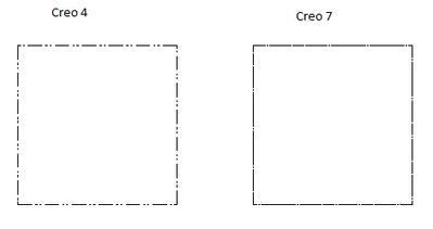

I could not find that config at all. I also have a similar issue.  We are going from Creo 4 to Creo 7.  All the configs, pentable, etc....are the exact same.  The PDF export on Creo 4 is different than Creo 7 and I cannot figure out why.  I also did some testing and all the older drawings we use dont have this issue (when I say older these drawing started like 5 years ago).  Any new drawings or even a drawing created back in 2017 has this line style issue when doing an export with Creo 7.  Its a very weird situation.  See attached pictorial.  the phantom line style is normal in Creo 4 and in Creo 7 it much tighter/looks like solid.  Hope someone can help.

It is a hidden option that you need to enter into your config.pro manually.
To check out ALL config.pro options, look at www.creosite.com. Olaf has done a great job of listing all the config.pro options, both visible and hidden.

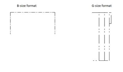

Perfect! I applied that config and it fixed the issue.  Now I do have another issue and this has been going on forever with G-size sheets.  The phantom line style never looked like B-size see attached pic.  The spacing is always larger so at times when you have smaller boxes that are phantom they will not show up phantom because the spacing.  Before I applied your hidden config fix to the B-size the export on a G-size on Creo 7 was much better than Creo 4.  But with the hidden config applied it reverts it back to were the phanton line style on G-size sheets are terrible.  Any ideas how to fix this?

please read old discussion ... https://community.ptc.com/t5/Data-Exchange/Line-Style-change-due-to-Format/m-p/485584#M1720 ... maybe it helps you to solve G-size problem.

Look at Article - CS321071 for the resolution.  In a nut shell there is a hidden config setting intf2d_out_pdf_scale_line_fonts that needs to be set to no.  go to File / Options / Configuration Editor and select "Add..." button. enter the config name, set it to no and select Ok.
