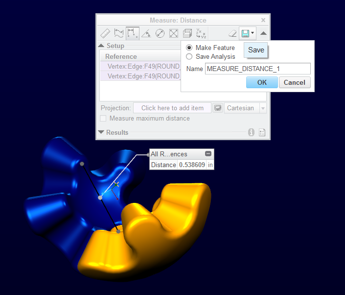

There was a feature where you could measure, say, the length of a spline (curve, edge, etc.) and it would make it a parametric parameter.  You could then use this parameter to make, say, a straight line of the same length, that would change as the spline (etc.) length changed.
For instance, I had a hydraulic tubing routing I got to the length/curvature etc. I wanted at assembly, where it worked with all the motion of the parts and had what looked like the right about of slack.  I made the evaluate feature for that spline length in the part, made an alternate straight trajectory of the same length in the part, and made a family table of that where for the drawing, the instance would be a straight line of tubing.  This way if the routing (thus length) changed, the straight length in the dwg changed accordingly so they could procure (or cut) the right length.  Now I can;t find that evaluate feature.
I also used it to drive spinal bends to make the straight length of something equal to the curved length.
Now I can't find that feature.  It was probably deleted or hidden like the N-Sided mesh as an "upgrade!".....
Ah, yes, that is the "Measure"  function that can make a parametric feature of the calculated value.
Patriot_1776
(To:TomD.inPDX)
I THOUGHT that's what they did, but haven't been able to access it or make it work.  I'll have to play with it more.  If I can get it to work, it'll be easier than it used to be, so that'd be nice.
That is one nice thing in NX, where if you measure something (length, diameter, etc.), and check the box for "Associative" it creates a parametric feature with a dimension (PXXX where in creo a dimension is dXXX) that you can use in "expressions" (their version of relations).
Now I'm curious why I wasn't able to get it to work,,,
Same in Creo... just "Save" the measurement in the dialog and you get more options.
At that point the measurements become accessible parameters.
And you get a "feature" in the tree so you can edit it 🙂

Ah, ok, I finally got it.  Grazie!  I was using "Save Analysis" instead of "Create Feature".  I like this new functionality (oddly enough, like NX) better than the old functionality.  Once you know where the button is, it's easier to create than the old "Evaluate Feature", even if it has a little less functionality (can't name the parameter what you want, only the feature name - that sux!).  And actually, I have to say, NX's functionality is much better, as it creates a dimension (Pxxx) that you simply reference in the dimension modification box of your straight line (or whatever) instead of having to write a relation and do the whole "d389 = LENGTH:FID_MEASURE_LENGTH_1" thing.  STILL requires a second regeneration to force a straight line to the developed length of a 3D curve though, so that's still maddening as ever.  When is PTC ever going to change THAT???

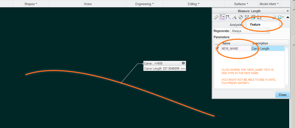

One thing is that you can name the parameters of the analysis feature, like so:
(Creo 2.0 - maybe this "easter egg" has been fixed since then...)
