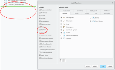

I've never had this issue before, but I got a new computer with the exact same installation of Creo 8.0 so why would I expect it to behave the same. For some reason, sections no longer appear in the model tree when a file is opened.
Now if I try to create a new section, then magically all the existing sections appear in the model tree and I can select them, but NOT UNTIL I CREATE/CANCEL CREATION A NEW SECTION. This is supposed to be controlled with the model tree filters, but checking and unchecking the box does absolutely nothing. Now once I've opened the section creation dialogue box, then the checkbox does what you would expect. But not before you've begun section creation. Really?!?!? Can't you get anything to work right?

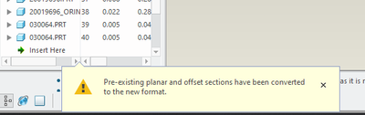

Is this an old model you are opening to revise? The sections have to be "upconverted" for older models and the way you describe that they only show up once you start creating a new one is the way I seem to remember it works when opening an older model.
StephenW
(To:jflatt)
I just opened an "old" model that doesn't show the sections in the model tree but once I try to create a section, it converts the "old" sections...notice the notification. (Creo 4)
