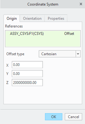

Hi all,
For the need of exporting a BIM model (using BIMDeX ifc exporter), I must set an export coordinate system located at a very long distance from the local coordinate system of the project.
This export coordinate system is located round 2000 km in X and Y axis (don't ask me why !) and Creo 7 doesn't accept such length. The project is about 150 meters long with parts of some millimeters dimensions.
Is there a solution to deal with such length into Creo 7?

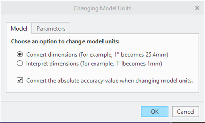

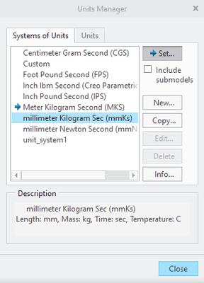

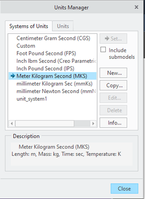

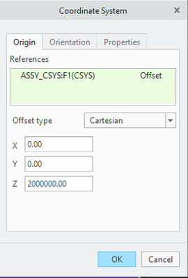

Finding and setting the hidden config that controls maximum value, as @MartinHanak suggested, would be ideal. However, you may be able to work around it.
Try starting in meters. Place your CSYS at desired distance. Change back to millimeters selecting convert. This should get you the larger value required.
