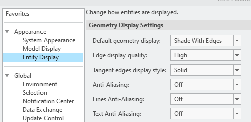

Looks to me like you have anti-Aliasing turned up:

Thank you, you are right.
