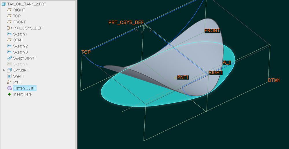

Instead of using sheetmetal mode, consider using the flatten-quilt tools in the surfaces menu in the Part modeling tab.
Your sample data, shelled, and then the outer surface flattened:

Your surfaces are not developable. They must be a smooth surface with zero Gaussian curvature. Developable surfaces include the cone , cylinder , elliptic cone , hyperbolic cylinder , and plane .
The upper shape does not have zero Gaussian curvature. You can query your model using the shaded curvature analysis tool. If it reports non zero values then the surface can not be flattened without distortion.
I put a surface of revolution (cone) in your model (yellow surface) that aligns on the symmetry plane of the upper surface. You can see that it has zero Gaussian curvature but is not congruent with your desired topology. If you run the analysis on your model you will see that the top surface does not satisfy the requirement of zero G curvature. The good news is that the bottom surface does and should flatten in sheet metal.
Use the flatten quilt with caution, it makes approximations that may not actually yield a flat pattern blank that can be made into your part. I would test that method on paper before blanking metal with it.
