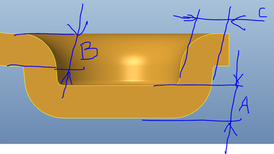

I would like to get sheet metal part with different thickness after forming ( coining ) operation
like the attached image below. Any idea
As Ben mentioned, sheet metal, while you can do punch and die operations, it will NOT (to my knowledge, at least with Creo 😎 thin the material out.  You COULD do all the work in sheet metal, and then MANUALLY do a cut to thin the material out.  OR try and do it as a regular solid model and make a shell feature with different thicknesses and it MIGHT work.

Creo Sheet Metal is for press brake operations of uniform material thickness. Die forming is a different operation and cannot be done in the sheet metal module.
Model your section profile and revolve it will be the best method for creating the solid model boss/dimple to your required thicknesses.
You could model the cross-section into a press brake operation to get an approximate 'flat pattern' length, but die forming does not deform the material the same way a press brake operation does.
