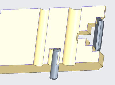

When I turn on a cross-section, some solid models appear as surface models. They appear as 'hollow'.
Nevertheless, 'Show Clipped Model as Solid' is checked on in 'Options', and 'Capped_clip' in config.pro is set to 'yes'....
Any suggestions as to what could be wrong?
( Creo 4.0 )

EddyVE
(To:tbraxton)
Nope, the shaded-to-wireframe and then back doesn't work for me...
I am having a section showing this problem now and changing display mode does not alter anything.
Weird thing is, some parts are shown as solid (yellow part) and some are shown as hollow (grey parts) .....
And the section was displayed fine the other day ......

In fact, I just found out I don't even have to delete the section. I just have to do 'Edit Definition' of the problematic section, do nothing, just hit the green checkmark to exit editing and now the section is back okay .....
PS. I designed the part myself, same as always, so I am sure it is a solid ..
Here's what it looks now:

This annoying problem came back to haunt me again ....
What used to 'work' for me was to do a 'Edit Definition' of the troubled cross section, then click OK, and the hollow parts would appear as solid again in the cross section.
Now even that doesn't work anymore.
When in the 'Edit Definition' mode, the cross section appears okay (as solid / capped cross sections). After leaving the 'Edit Definition' mode, some parts appear again as hollow.
This must be a bug,  plain and simple ... ☹️
In the screenshots you can see the 2 representations ....
During 'Edit Definition' the cross section looks like this:

Hi Mahesh,
Thanks to your suggestion (dragging 'Insert Here' from the top down), I was able to pin-point the problem.
It turns out that the hollow components had constraining errors in the assembly.
After repairing the constraints, the failing components did not appear hollow anymore but solid.
Thank you very much for your help!
