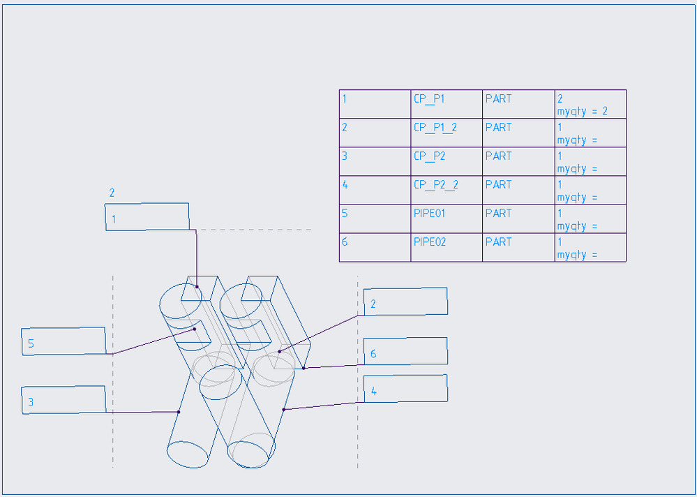

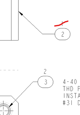

Hello, We are setting up repeat region BOM tables. Our standard is not to put a "1" on a balloon if the qty is only 1 each. Is there a way not do display a quantity of 1 and still keep the tie to the table?
1.] you have to define repeat region relation
2.] you have to define&apply BOM custom symbol
3.] example
3.] example

Worked perfect!!! Thank you!!
