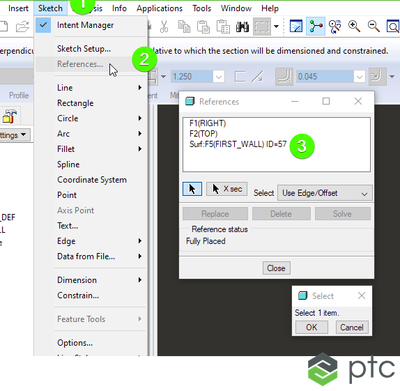

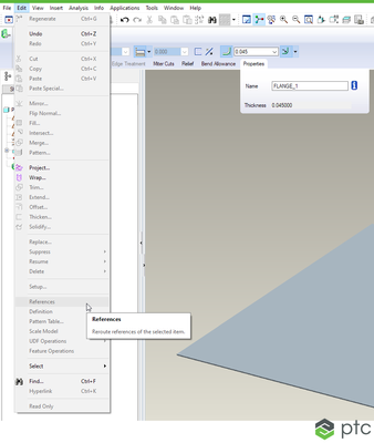

Hi after firing Wildfire 4.0 i was unable to access the Edit > References menu:
Is there something you did differently?

Do you mean this mean:
Browsing : Sketch > References ?
Menus from Wildfire 4

JD_9876527
(To:remy)
In your screen capture, the selection "Sketch Setup.." is the function I am referring to.
