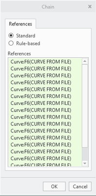

Thanks for the video. I have made some try. The shift + right clic work perfectly on a 3d part edge.
But, because my client send me 2d DXF and DWG files, I open in in a part. And I have to sketch all his hole pattern on my model. But with line form a "Curve From File" feature, the shift + right mouse bouton does not work very well.

By making test with a selection of 2d Curve from a import, select the fist line, then open immediately this selection windows. This help with the rapidity that the curve are selected.

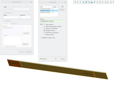

Can I suggest something in the sketch? In the sheet metal, if we unbend a part , and we want to make a sketch of all the outside of the part, the chain or loop selection stop at the bend, and it will take only the edge of the surface.
Some time this will be useful, when I want to simulate a perforated sheet, but I don't want hole on the edge, because I will punch the hole in house instead of purchased real perforated sheet. This will sketch allow to make a fill pattern, with a border to not have hole on the edge. Now I have to sketch manually all the flat part.
This not something that I do often, but if you can add this, this will be useful.
Hi Ratty,
yes, in general we can think about additional useful chain collection rules.
One way to address your requirement with the currently existing Creo tools would be:
1) Create a DRF (datum reference feature) collecting Tangent surfaces (
     Note: the DRF supports the advanced surface collection mechanisms from Flexible Modeling. Not all features will then accept such a collection, but the subsequent copy/paste surfaces does.

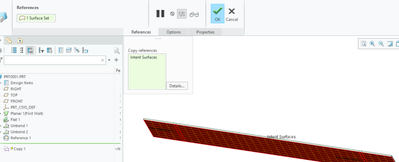

2) Create a copy-surface (copy/paste) based on the DRF surface geometry collection.
    for example by:  right-click selection via "Pick-from-List" / Choose your intent reference / Copy / Paste
 3)  As a result you get a quilt of which you can project the boundary loop into your sketch for the Fill Pattern
That process should be pretty stable and update upon regen.
Hope that was what you were referring to.
