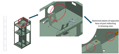

Hi All,
I am facing a problem in Creo drawing view where, the Sketched labels of opposite face of part reflecting in drawing view of assembly.
I tried to hide in the layer tree but the complete sketched labels will get hide in the part level that is not right i feel.
I tried to create new layer and add the labels in the assembly layer tree, then i tried to hide them, then also it was not possible to hide them in the views.
Am i going in right direction or any other method to hide the visibility of sketched labels of opposite face of part mode in the drawing view ??

suggestion: create simple part+assembly+drawing that behave inappropriately. Pack them into single zip file and upload this zip file. This enable community users to show you a solution.
INFO: Every drawing view can have its own layer status which is independent on model.
