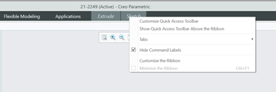

Good morning all!
Doing some work in CREO Parametric 8.0.8.0. and after some time I realised that during sketching in a feature the ribbon is gone. I have to click "sketch" again to get all the options.
ctrl-F1 is not working nor is double-clicking.
Right button shows "hide ribbon" greyed-out.
How can this be resolved??

It seems to me this is caused by pressing this arrow.
With the arrow pointing upwards:
With it pointing downwards:
This is the fix I found using creo parametric 9.0.
3 REPLIES 3
Haha simple as that...😂 thanks for your help.
