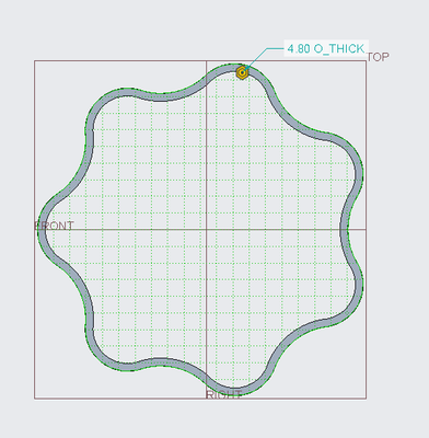

As can be seen below, my outer dia and inner dia in the part sketch tool are 208.1 and 173.9 respectively.
I have then shelled the extruded model.

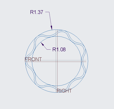

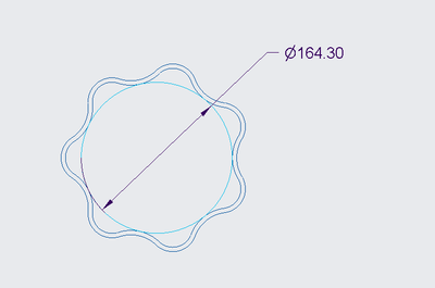

I want to check if the internal dia of this model is what I want it to be. To do this I make a drawing of the model and using a three tangent make a sketch of the internal dia. The resulting measurement however does not seem to reflect the actual inner dia of the model and instead the corresponding drawing measurement taking the scale into account. Is there a way to find the inner dia via the drawing?
I am using the c_drawing template on creo paramteric 9.0 student version
use Relate View command. See video.

Sketching in the drawing is always a problem.
Make a sketch in the model so you can constrain. You will get 100% accuracy and you will be sure you are correct.
Then, if you need it, you can show the sketch and dimension from that sketch in the drawing.

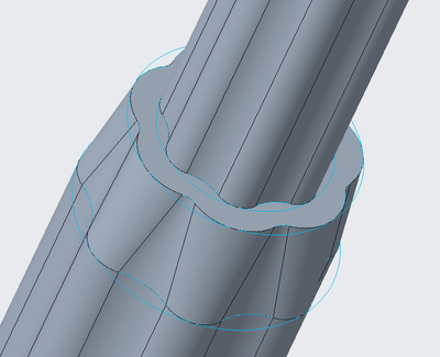

If someone encounters a similar problem. I have created the sketch as such in the part.
This subsequent sketch is then visible in the drawing and I have gotten the accurate measurement from it, although doing this in the drawing specifically is not necessary as mentioned by Stephen.
