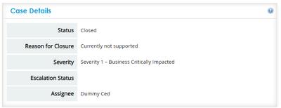

I have seen this before, PTC has an SPR assigned to a similar issue. Please call PTC tech support and reference this SPR# which I filed in Creo 3 in 2016, they have not fixed the issue and closed the case. If more people log the issue, it is more likely to get attention. In my case it is not an accuracy issue.
This is the last update from PTC on the issue:
"This case has been reassigned to me as the previous TSE, Tejas is no longer at PTC. It looks like you requested a status update a couple months ago as there had been no status update since late 2016. The SPR has had some progress but not recently. The development team working on it had identified where the regeneration is not occurring but has not made any changes to code or suggestions on how to proceed."
Reported to R&D as SPR 5777992
This is the current status:
