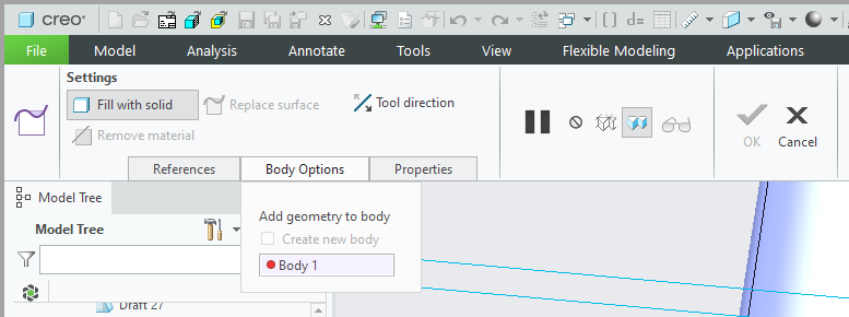

We're in the process of upgrading to Creo 7 from Creo 4, and when I open many of our models created in Creo 4, the Solidify features all fail.  It appears to be struggling to assign the new solid to a body.
If I create a dummy solid prior to the first Solidify, then I am able to access the "Body Options" tab in the Solidify tool and get it to work.  However, the Solidify features below it all still fail.
Is there a config setting I'm missing, or a way to disable the Multi-Body feature on legacy models created in prior versions?

Update: This is where I'm getting stuck again.  The solidify command won't solidify to Body 1.
I'm worried this might be just poor modeling because a prior solid was converted back into a quilt and then is attempting to resolidify.  I'm new to using Bodies; does this confuse what Creo thinks Body 1 is?
This solidify also acts up in Creo 4 sometimes, but I'm usually able to regenerate and resolve it.  So that's why I'm inclined to believe it's getting hung up on the new Multibody functionality.
