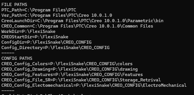

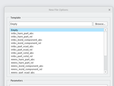

I recently switched to CREO 10 and the start_model_dir and template_### in the config file don't seem to work.  When I start a new part, with the use default template option picked, a "New File Options" screen pops up and my templates are not there.  If I browse, it goes to the "start_model_dir".  Is it going to be like this all the time?  This opens up the possibility of choosing the wrong template.  It leaves with questions:
1) Why didn't the new part use the template that is assigned in my config file when the "default template" option is chosen?
2) Why aren't my templates shown in the "New File Options"?  Why do I have to browse?

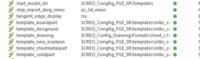

I found my mistake the parameter in my BAT file was
CREO_Config_File_SR
the parameter in my config file was
$Creo_Congfig_File_SR
I corrected and it is working as it should.

My config file is loaded.  My BAT file to start CREO looks to be setting everything correctly.
When I try a new part
I still get brought to here.
Have you recently upgraded to Creo 10?  It looks like you are trying to use the default Creo templates.  Your config is looking for inlbs_part_solid.prt, but the default options in 10.0 are inlbs_part_solid_abs.prt or inlbs_part_solid_rel (absolute or relative accuracy respectively).
I am just switching over to CREO 10.  I am not trying to use the default templates.  I am trying to use my templates.  That is why I have templates set in my config file but they are not loading.  I am being directed to the default templates.

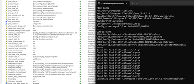

At the top of the Options window, is your config file location correct?
Your Options show $CREO_config...  This would be pointing to the load point templates (default PTC supplied templates).  Your templates should be located in a separate folder from the program location such as C:\user\MYR\Creo\templates
Your start directory is where your congfig.pro file should be located.  This is also your default working directory.  C:\program Files\PTC\Creo 10.0.1.0\Parametric\Bin is not a good place for either. (C:\user\MYR\Creo would be more appropriate)

I have BAT files to launch from different startup/working directories for each of my clients.  They point to different startup/working directories.
That looks right, the only thing missing is the first read is a load point config.sup if you have one that cannot be overwritten.  Your options window will show a lock for anything set by a config.sup.
I am not very familiar with using a batch file for starting Creo, but your bat file shows the start directory as C:\program Files\PTC\Creo 10.0.1.0\Parametric\Bin which is what sets the initial working directory.

I have changed the path names a little so it isn't so confusing
CREO_Config_File_SR
