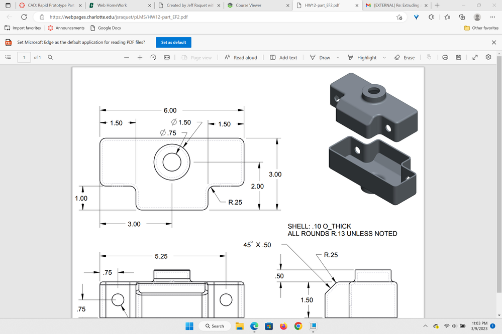

Starting the drawing
How should I start this drawing

I assume you want to create a model of the part.
One approach:
Extrude the "T" shape with sharp corners (in top view)
Add the boss on the top
Add the chamfer
Add the rounds to the external rounds to "T" shape
Shell the model using the bottom face for removal
Add the two holes in the front view
Add the hole in the boss

BenLoosli
(To:KC_10566988)
When your model is done, File-New-Drawing
Choose a drawing template or a blank sheet
Put the top view on the sheet
Project the other views on the sheet
Show dimensions in each view, if the model was defined with those dimensions
If the shown dimensions are not right, add dimensions in the annotation tab
