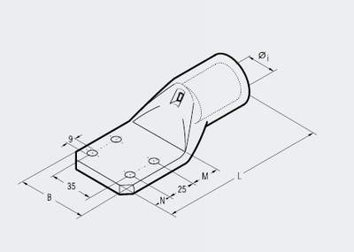

Hello, I was wondering if anyone knew if Creo Parametric is capable of producing drawings like this:
Not sure which this drawing was produced in, but it follows the conventions I was taught during technical draftsman classes in high school, and technical sketching classes in uni. Key thing I would like to achieve- the boundary lines are thicker than internal lines, and if there is a way to make a bottom or part-overlapping edge thicker than standard outer lines that would be great too. Haven't seen anything online that relates to this. Not sure if it's even possible.
Thanks!

Creo Parametric is not capable of producing drawings like this. I guess the picture was created in Creo Illustrate.

Thanks Martin, I'll take a look at Creo Illustrate.
