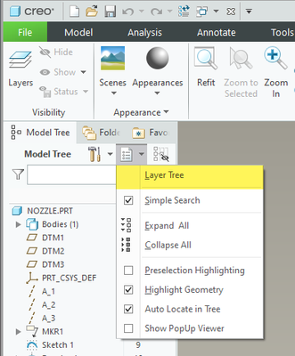

Open the layer tree and change the layer status to visible. Then you should be able to see the features.
The layer tree can be activated here:

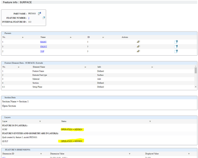

Can you confirm that these features are not being placed into a layer automatically? Use feature info to query what layers they are on if any. They may be placed on a hidden layer when created.

D_Hale
(To:tbraxton)
I'm not really familiar with Layer-Use in CREO, so I'm going to have to dig into how to modify that layer setting.
It would seem that from the screenshot that may be the issue. I'll report back once I find where to adjust layer properties.

D_Hale
(To:tbraxton)
That was the issue!
Both Quilt and Surf needed to be enabled as SHOW
I wonder if these are default CREO layers or customized environment settings by our corporate CAD management.
Regardless, thanks for the assistance!
