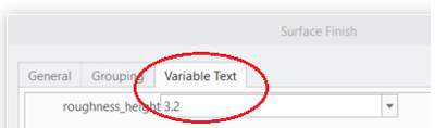

Type in 3.2 as shown in below snapshot. Otherwise create a free Note "Ra 3.2" and relate it to view.

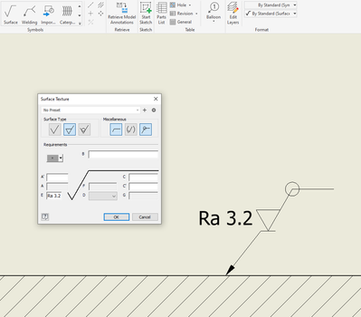

Can you show exactly what you are needing?
Sergey
(To:StephenW)
Hello Stephen.
Yes, sure. Here is example from Autodesk Inventor. Done in a couple of seconds.

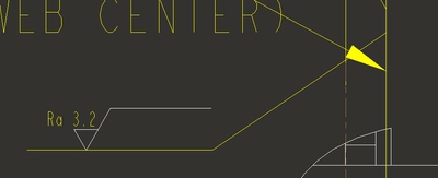

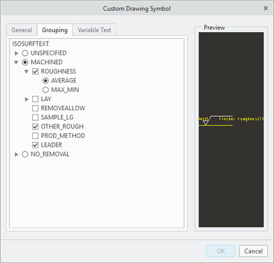

I'm on Creo 4 in a drawing. I'm not sure what has changed since creo 4.
I have symbols in a Creo folder C:\Program Files\PTC\Creo 4.0\M130\Common Files\symbols\library_syms\isosurftext
Your folder will likely be different based on your Creo install.
The symbol in there is called isosurftext.sym
I add that symbol to my drawing and I can get everything except the all around.

StephenW
(To:Sergey)
In a drawing, Symbol, browse, system symbols, isosurftext, then choose isosurftext.sym
May be some difference in Creo 4 vs Creo 7
I have no faith they have updated the symbol in any way.

Sergey
(To:StephenW)
Hello again.
Just want to notify you that it work very well.
