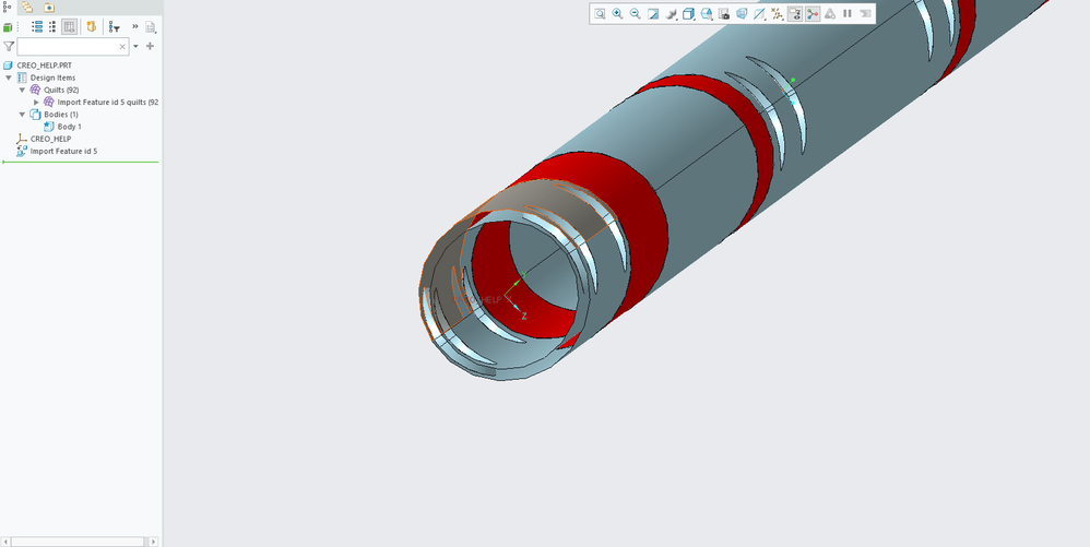

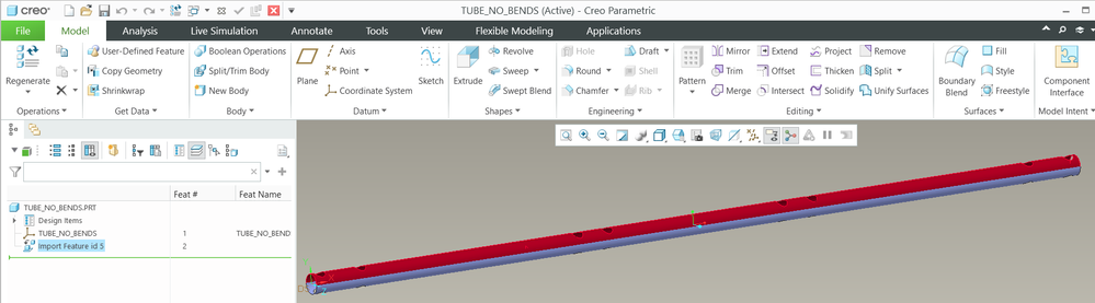

hollowish tubehollowish tubeI use this software called TubeWorks to unbend tubes with features in them for laser cutting. The problem is the step file TubeWorks creates is mostly hollow, has no ends, and has several quilts. (see attached picture)
I've tried merging the quilts and solidifying but it still comes out with multiple surfaces. Any ideas on how to turn this part into one solid piece without losing the holes? I'm using creo version 9.0.5.0.

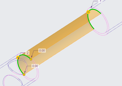

Some of the holes have pink edges, which means the surfaces are not joined at those edges.  I would solve this by deleting the surface and recreating it with the boundary blend tool, same as above.
  • Delete the highlighted surface that contains a pink edge.
  • Use the merge curves command to ensure that each of the 4 edges that make up this surface are composed of a single curve each.
  • Activate the boundary blend tool and create a new surface as shown.
  • Drag the newly created surface into the quilt.  Repeat for any other hole geometry that has a pink edge.
  • The small triangular hole is missing inside surfaces.  Use the process above to create 3 individual boundary blends (after merging curves) and drag those surfaces into the quilt.
  • Same thing applies to the endcap surfaces.  Create separate boundary blends between two semi-circle edges (after merging curves) and drag those into quilt.

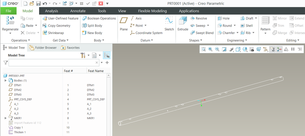

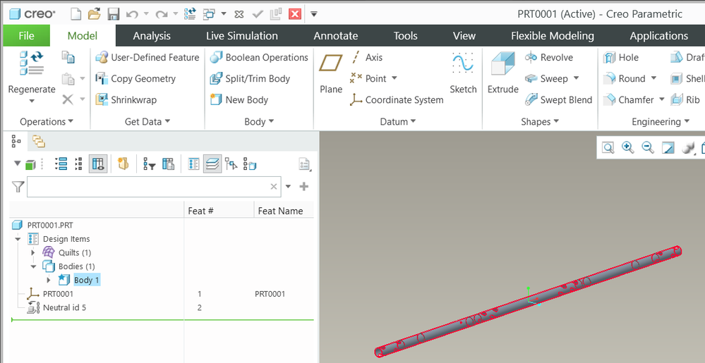

Assuming the laser is cutting normal to the tube radial surfaces you can get your model without messing with IDD. I was able to generate a solid model of the tube in 3 features (including the import feature). Open the enclosed Creo neutral file to verify geometry accuracy. It is in units of mm but it is a solid model of the tube with all cuts. I did this in the interest of expediency; I am not discouraging you from exploring how to use IDD as it is a valuable tool in some cases, just not the quick solution to this problem.
I copied the outside surfaces of the tube from the STEP import and thickened the surface copy to generate a solid model. This will be much faster than messing with corrections of import data in the IDD tool.
If this process is something that you will re-use and are looking to standardize as a best practice, then there is more work to be done here. I would start on the TubeWorks side as the STEP data is exported in way that is not particularly suited to just importing a STEP file to get a solid Creo model.

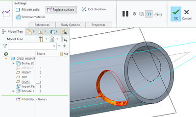

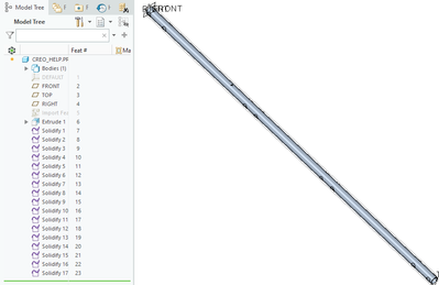

As always, there is more than one way to "skin the cat."  In this example, I used IDD to create a more useable set of imported surfaces and quickly recreated the model.  I don't think you can get much simpler than this or automate the recreation.
  • Import with external accuracy.
    • Recreated missing hole surfaces (triangle).
    • Deleted most tube surfaces, keeping one at each end for reference.
    • Pulled remaining tube surfaces out of related Quilt
  • Extrude solid pipe using save surfaces for length and edges for diameters.
  • Queary select each set of hole surfaces and use solidify to create hole.

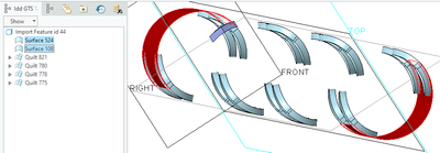

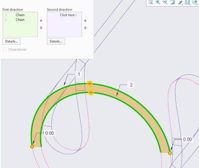

It's difficult to explain how to use IDD in this format but here goes.  The goal in IDD mode is to convert all of the pink edges into purple ones by creating surfaces and joining edges.  Once they are all purple, you'll end up with a solid after closing IDD mode.
  • Open IDD. In the feature tree, move all of the surfaces into a single quilt.
  • Delete the red surfaces in your picture above.
  • Merge the curves that make up the ends of the two different cylinder surfaces. Currently, cylinder edges are divided into two or three curves.  Select the curves and click Merge Curves.  Repeat this process for all cylinder surface edges.
  • Use boundary blend tool to create new red surfaces between opposing cylinder edges. This step will be much more difficult if you don't merge the curves beforehand.
  • In the feature tree, drag the newly created surfaces into the quilt.
    This will get you started.   I'll add more in a separate reply.

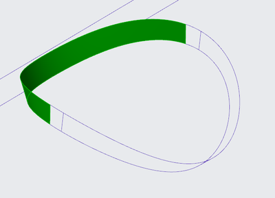

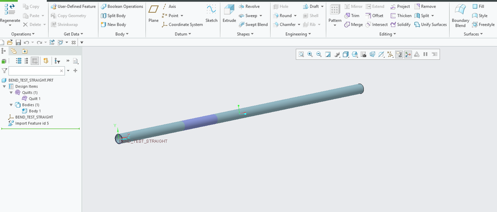

Alright so I made a tube with one bend and no holes just for simplicity. I merged the curves, deleted the red surfaces then boundary blended the end caps and gap where the red surface was. The problem is that my laser isn't registering the blended center section, instead it thinks this is two separate tubes (one on either side of that purple blended area).

The neutral file I posted earlier is a single solid body. In your OP you asked for a single solid part with the holes preserved. The neutral file posted satisfies this requirement in Creo as is seen below in the screenshot. If there are additional requirements (related to your laser programming software?) to resolve the issue, then you will need to elaborate on what those are.
Involute Development, LLC
Consulting Engineers
GG_14369233
(To:tbraxton)
The neutral file does come in as a single solid in Creo.
The issue isn’t with Creo showing a single body, the problem happens when exporting this model for tube-laser programming (Bodor WiseCAM). Even though Creo treats it as one solid, the STEP still contains multiple surface segments at the previous bend locations.
WiseCAM reads those surface splits as separate tube segments instead of a single continuous tube, so it fails to recognize the tube length and geometry correctly.
