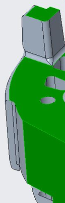

I have a problem to visualization some surfaces.
When opening an assy or only the part some faces are not  showed correctly.
The problem is not in all parts and assy that I have. In other files with similar assy them are showed ok.
faces like trasnparency.
see faces selected with problem
If I make a section view, I see the solid not surfaces.
Well, I hope any help.
Regards.

These types of issues are often a graphics display problem. Are you using a PTC certified hardware configuration? The first thing to try is to turn on shade very small surfaces in the options tab. You can also alter the display quality and create some simplified reps for testing. The fact that it only occurs in some assemblies would suggest that is a graphics display error.
You can also try setting the graphics to use the win32-gdi option for testing.
  • Use hidden configuration option graphics = win32_gdi

Hi, thanks for your help.
No, I have Dell but with Intel Graphic.
Anyway
Do to you comments, I have started to review the option.
So... when desactivating the "enable transparency" the faces have been displayed. They have a different colors though the material properties are the same in model.
To change color I had to reapply the generic material.
Well, really thanks for comments about it. Maybe it was too simple but, I don't understand why some faces displayed and other don't.
Thank you so much.
