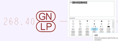

According to ISO 14405 - 1, it should be possible to further specify both tolerance values with a symbol in the case of asymmetrical tolerancing. E.g. ‘GN’ for upper limit and ‘LP’ for lower limit. How can the symbols be assigned to the tolerance values in Creo?

Here is an example of the symbols for ‘GN’ for upper limit and ‘LP’ for lower limit. How can I define them in creo?
kdirth
(To:MW_7632680)
I don't know that you can add it to the format of the tolerance but you can add it to the dimension text.

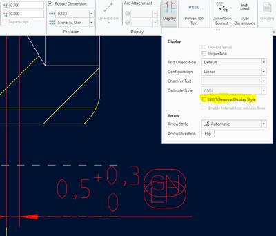

I have already tried this, but got the following result:
If I deactivate the ISO display style, it is also wrong:
do you have an idea?

Looks like your Display option and text style so not work with the symbols.  I think the best you will be able to do is add an offset note with the symbols and adjust the style height to fit.
