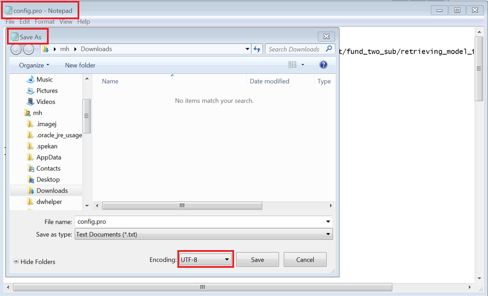

My configmine points at the correct location. but when Creo reads it it shows up like
in Config editor, so i have to reload it every time.
What must be going wrong here?
bsurve-2
(To:bsurve-2)
here is the file
I think that your config.pro file uses UTF-8 coding. Save it ANSI coding and test it.
Martin Hanák
bsurve-2
(To:MartinHanak)
Spot on...
Thank you so much Martin.
I never thought it would make a difference but glad it worked.
