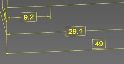

Hello
Using CREO4
in 3D model, using Annotate I create the Annotation feature to define the dimensions.
Is it possible to change the position of text for all dims (parallel and above) using any config option ?
see the dim "49" in the the pic !

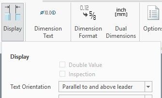

File > Prepare > Change Detail options (last one in the list)
6 REPLIES 6
in model set detail option ...
default_lindim_text_orientation PARALLEL_TO_AND_ABOVE_LEADER

Detail option by Martin will work for new dimensions, existing needs to be update separately.
The mentioned option works for Drawing and I got it.
How to manage the 3D Annotation Features ?
Pier
Ok thanks.
It works.
But there is not any option for config.
I suppose I have to change the Template 3D model.
Thanks again !

Yes, you have to modify part template.
