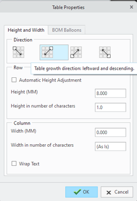

Currently, I see no way to have a "snap location' on the top right corner of my drawing that I can "snap" my BOM to every time I add one?
I want to be able to input "table from file", hit my mapkey (which has the appropriate xy coordinates), then it places it into the correct location. However I need the table to be placed using the top right corner but all my tables all get placed from the top left corner and there seems to be no way to change that?
My best method so far is to place my table, select it, hit my mapkey "F5", then click on my desired corner of the table, then my mapkey places it onto the correct xy coordinates that were included with my mapkey.
Not a huge workaround, but you should be able to change where a table gets placed from right?
If there's a better method that I'm not finding please share.
Thank You!

When you make your original table, you need to specify the direction to set the origin location.  To use the top right corner, select the second option, leftward and descending.

I'm using Creo 7 and have tried this method already with no luck. It did not change what corner it defaults to even though, to me, that makes sense.
I'll try it again.

Thank you. I was creating my tables a different way. This worked great!
