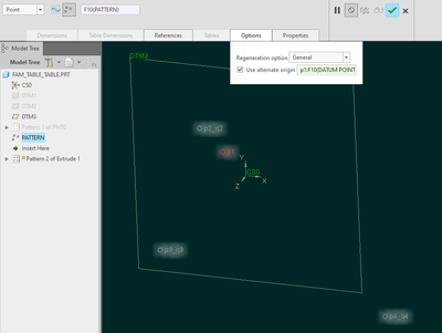

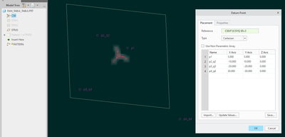

Hi Every one,
My requirement is to create an irregular pattern of holes. I have 'X' and 'Y' dimensions of points where holes to be made and will create a family table of patterns.
but, after creating table pattern the points are reversely plotted (-ve became positive and positive became -ve). I think it is taking relative position instead of absolute positions. I can reverse the signs to get the proper results but I have to use the exact values of 'X' and 'Y' dimensions.
I have attached the snaps of the problem I am facing. please help.
pausob
(To:SC_8321054)
Yes, I believe you describe the table pattern behaviour correctly and I suppose it works according to specification that all pattern members will be re-arranged to adapt to the new "sense" of the leader instance dimensions.  I don't think there is a way of specifying that the table pattern instances will be located according to some "absolute" coordinate system.  (if you could suppress the 1st instance in a pattern, then the work-around could be to have the 1st point be in the 1st quadrant)

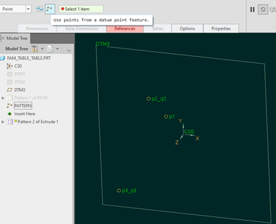

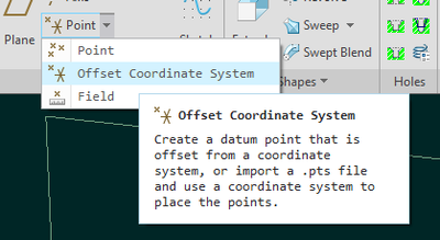

So I suggest using point-based patterns and specifying the points using sketches, or the "offset-coordinate-system":

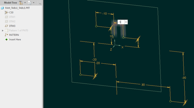

For example, define your point field:
now editing the 1st point, you can specify its placement in the 2nd quadrant:
and the other points "stay in their place":
Then you pattern your feature by using "by point" method:

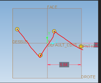

I checked 9-35 pattern, only. Point positions correspond with table defined inside in pattern feature. I don't see any problem. See picture. Minus sign is displayed because I added SHOW_DIM_SIGN yes option into config.pro file.

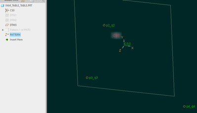

Yes, if you see pattern 15-97_S16, while plotting C, G, L and M (See snap attached in above post to get coordinates) the C point is in 4th quadrant. but Creo assigning it in 1st quadrant and other points are getting plotted relative to the point 'C' which makes them to get reversed.
the attached 1st image is the output I want. the 2nd one is the output I am getting.
Note: if the leader point falls in 1st quadrant, then there is no problem in plotting the point. problem rises only when the leader point falls under 2nd, 3rd or 4th quadrant, the sign gets reversed for other points.

I was expecting the same thing. I will go with point method.
