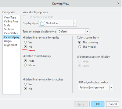

A couple screen shots would help to clarify what you are asking for.
Assuming you are asking about cosmetic threads, in the drawing view properties, select No for Hidden line removal for quilts.
