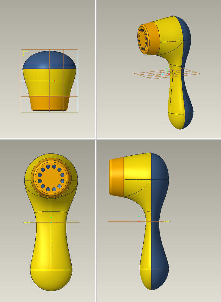

Hi!
I am working on a school project where we are using surface modeling to create a hair dryer suitable for injection molding (We are and have to work in Creo 4.0, just fyi). I decided to go for a more advanced modeling method where I make a boundary blend towards a projection on a complex "pane"/surface (as can be seen in image below).

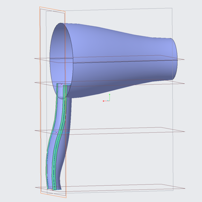

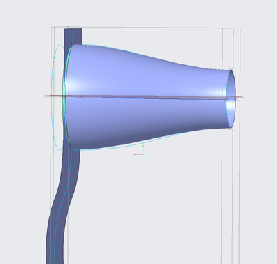

I use a ribbon as a tangent for the boundary blend, I create the ribbon with sketches and curves. The splines in the sketches are tangent to a horizontal center line, while the curves are tangent to axis that are perpendicular to the vertical plane. I do the same for the for the handle (see below).

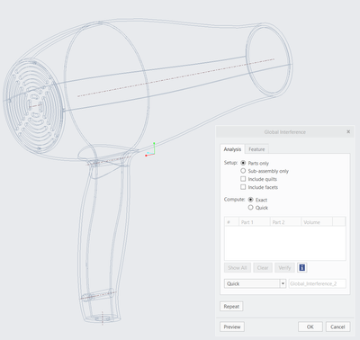

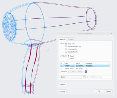

I then merge and thicken this. I use the top-down approach to make the back half referencing the relevant points of the front half. Lastly to my point and my issue, the thicken (even tough all boundary blends uses tangency to ribbons that where created with sketches and curves that are constrained in such a manner that they are perpendicular to the vertical plane) is not created evenly and tangentially which leads to the front and back half interfering with each other (as can be seen bellow).
I have tried a lot of different things but am on the edge of giving up on using a complex splitting "plane"/surface and simply going with a simple straight one instead. This is my last ditch effort to see if anybody knows how to solve this.

It is possible to build what you want using Creo but it is a bit tricky to troubleshoot without the model.
Based on your description of the issue I would try extending the handle surfaces beyond the split surface
Then offset them to the thickness needed. I would use offset, not thicken.
Use the split surface to trim the quilt(s) before merging them together. You will need to merge the inner, outer, and split surface together to create a closed quilt that will solidify..

I appreciate the heads-up about the limitations with the education package!
I decided to run a quick test based on your suggestion, and I'm happy to report that it seems like it will work perfectly for my needs. I'm not sure how I overlooked this as a potential solution, but perhaps I was experiencing some tunnel vision due to being new to surface modeling.
Your help has been invaluable and has probably saved me a lot of time! I appreciate your willingness to share your knowledge and expertise with me.
It worked. Everything is now perfectly lining up.

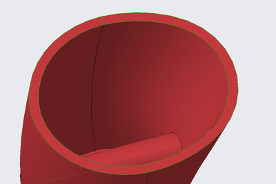

This is an example of a similar design for molding. @kdirth is offering solid advice to create a master model of the outer surfaces ( making sure it can be offset to the required thickness) and then split it.
This is a surface master used to create the 3 molded parts shown in the second picture.
