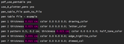

Hello, whenever I export my drawing as a pdf or print it as a pdf the lines are all pretty thick. Acutally so thick that you cannot see any real detail. I would like to change that.
I read a lot about this tabe.pnt file, but i cannot find it anywhere.
Also i tried copying the following in my config.pro file:
pdf_use_pentable yes
use_8_plotter_pens yes
pen_table_file path_to_file

I think the problem is that your defined thickness for drawing_color is so thick.
I set the thickness 0.026 cm, and it works fine. (You can reduce thickness until it looks good)

You should create a .pnt file and define the thicknesses inside that file, not in config.pro.
For example, if you create customThickness.pnt and put it into folder  D:\Creo_Config
The following option should be set in config.pro
pen_table_file D:\Creo_Config\customThickness.pnt
The contents of customThickness.pnt is similar to your text, eg.
pen 1 thickness 0.05 cm; color 0.0 0.0 0.0; drawing_color
pen 2 thickness 0.025 cm; color 0.0 0.0 0.0; letter_color
pen 3 pattern 0.5, 0.2 cm; thickness 0.025 cm; color 0.0 0.0 0.0; half_tone_color
pen 4 thickness 0.035 cm; color 0.0 0.0 0.0; edge_highlite_color

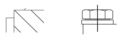

The central axes as well as the hatching is not effected by those changes:
I tried changing the values of the other pens, but also this did not help.

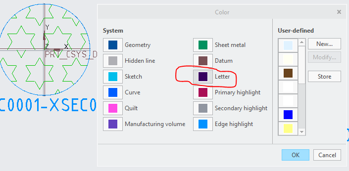

In explicit i tried changing the following values:
Does sombody have any idead how to fix that?

Axes ...
By default axes have brown color. In this case you have to add datum_color keyword to some pen.
Eg. pen 2 thickness 0.025 cm; color 0 0 0; letter_color; datum_color
X-hatching ...
What color is assigned to you x-hatching? In my case it is Letter (pen 2 in your pentable)

If you reduce the thickness of all pens but the hatch and central axes are still thick, it is because the colors assigned to them are not specified in the .pnt table.
As MartinHanak has pointed out, you should first determine which color is assigned to which entity, then make necessary changes to your .pnt file. I guess what you need is section_color and datum_color.
Note that one pen can be used for multiple color_name, for example:
pen 1 color 0.0 0.0 0.0; thickness 0.02 cm; drawing_color, section_color, datum_color
FYI ... section_color is assigned to Sketch features .
