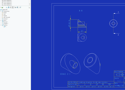

Hi everybody.
I cannot remove the thread lines where you can see the part have an extrude. The lines from the hole are gone if i remove the thread, but the lines from the thread appear again when turned on.
Hope someone can help

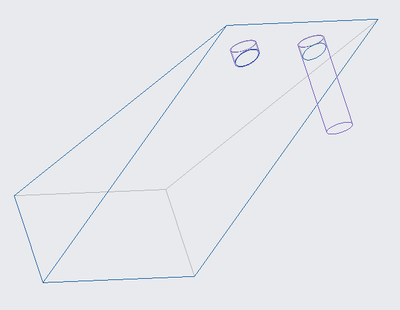

if you change feature order then you will get what you need.
Hole 1 ... created before Extrude 2 ... displayed right
Hole 2 ... created after Extrude 2 ... displayed left
