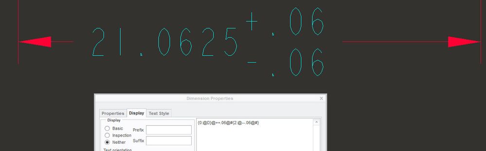

I have changed a dimension's name to "L" for length and used @S to display it on the drawing. Is there a way to display a symmetric tolerance I assigned to the dimension?

You can add the tolerance in the dimension text properties (no need for a separate note) by placing the tolerance values within @+...@# for the upper tolerance and @-...@# for the lower tolerance. Without including a space between the groups (looks like @+...@#@-...@#) the upper tolerance will be placed above lower tolerance.

Is this what you mean?
Syntax for over/under work in the dimension too
{0:@D}@++.06@#{2:@--.06@#}
